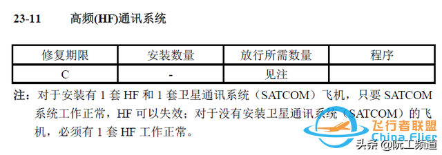

高频系统检查需要一个距离100英里以外的地面站来发送信号。如果无法完成测试,可以MEL保留:
维护提示 | 737NG雷击后需要测试ELT和HF-6598

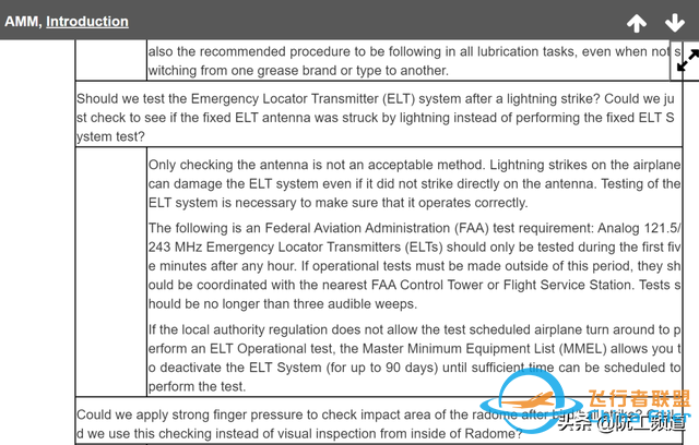

关于雷击后要完成ELT操作测试的问题,波音在737NG AMM手册的介绍部分的 Frequently Asked Questions for the AMM 也进行了说明:
维护提示 | 737NG雷击后需要测试ELT和HF-6939
Q:Should we test the Emergency Locator Transmitter (ELT) system after a lightning strike? Could we just check to see if the fixed ELT antenna was struck by lightning instead of performing the fixed ELT System test?
应该在雷击后测试ELT系统吗?是否可以不执行固定式ELT系统测试,而只检查固定式ELT天线是否被雷击?
A:Only checking the antenna is not an acceptable method. Lightning strikes on the airplane can damage the ELT system even if it did not strike directly on the antenna. Testing of the ELT system is necessary to make sure that it operates correctly.
仅仅只检查天线是不可接受的。飞机雷击后可能会损坏ELT系统,即使没有直接击中天线。必须对ELT系统进行测试,以确保其正常工作。
The following is an Federal Aviation Administration (FAA) test requirement: Analog 121.5/243 MHz Emergency Locator Transmitters (ELTs) should only be tested during the first five minutes after any hour. If operational tests must be made outside of this period, they should be coordinated with the nearest FAA Control Tower or Flight Service Station. Tests should be no longer than three audible weeps.
联邦航空管理局(FAA)对ELT测试的要求如下:121.5/243 MHz的ELT信号测试只能每整小时的前5分钟进行测试。如果必须在此期间之外进行操作测试,则应与最近的FAA塔台或飞行服务站协调。测试应不超过三声可听见的警告音。
If the local authority regulation does not allow the test scheduled airplane turn around to perform an ELT Operational test, the Master Minimum Equipment List (MMEL) allows you to deactivate the ELT System (for up to 90 days) until sufficient time can be scheduled to perform the test.
如果短停时,受当地局方的规定限制无法进行ELT操作测试,MMEL允许失效ELT系统(最长90天),直到有合适的机会可以安排进行测试。
