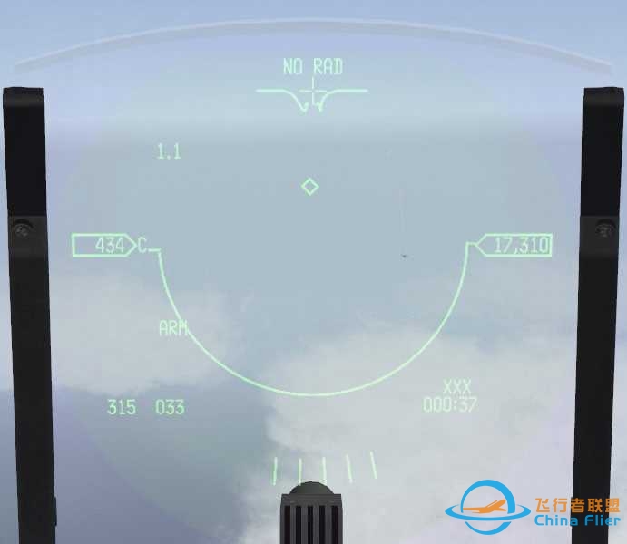

请问各位飞BMS的大佬,我遇到的究竟是怎么回事,每次一起飞收起落架,HUD就会变成这样,万望各位不吝赐教,感激不尽! 请教HUD异常显示模式问题-1517

这个问题出现过几次,每次都曾经做过从舱内切换到外部视角的操作,是用快捷键D0或D9切出去,再用2或3切回来,有时,是有时就会出现这个现象,真让人头痛不已
楼主 发表于 2025-12-11 14:50:32 | 显示全部楼层
在游戏文档TO 1F-16CMAM-34-1-1 BMS的第2.3.1.4.5里描述了这个hud显示,根据其解释,出现这个情况的原因可能是我的FCR处于STBY状态,没有开启扫描。问题是自从我学会了开启FCR后,就没有再出现过这个现象,下次应该试试能不能复现一下,印证一下是否是这个原因。

2.3.1.4.5 NO RAD / NOT SOI DISPLAY
Two displays are provided on the MFDs and HUD/HMCS to improve response to FCR operations.
The NO RAD display is provided on the HUD/HMCS to indicate that the FCR is not radiating. Situations that create this possibility are as follows:
• STBY/OVRD submode selected.
• RF switch in QUIET or SILENT.
• ACM:
o Initial entry into ACM (without a bugged target from another air-to-air mode) 30x20 NO RAD.
o From any ACM radiating submode, TMS down also enters ACM 30x20 NO RAD.
o With HUD as SOI, TMS down commands ACM BORE NO RAD when the FCR is slaved to the HMCS.
o With HUD as SOI, TMS up and held commands ACM BORE NO RAD when the FCR is slaved to the HMCS in BORE.
o With FCR as SOI and ACM radiating, TMS down rejects the target and commands 30x20 NO RAD (if FCR is not slaved to the HMCS in BORE).

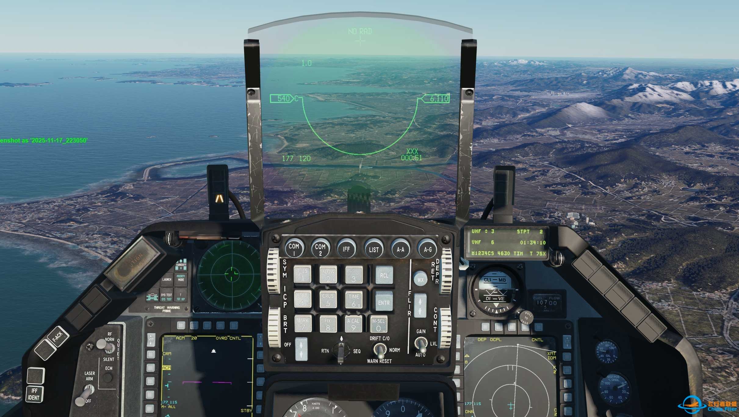

看起来你仍然启用了防空或“空战”模式,要么点击控制面板上的“AA”按钮,要么点击 C 键或你绑定到取消键的任何按键。
