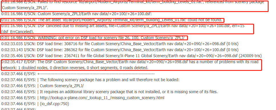

老是说我没有地景库,怎么办???
发表于 2020-3-3 01:07:32 | 显示全部楼层 |阅读模式
0:01:16.986 E/SCN: Failed to find resource 'lib/airport/Modern_Airports/Terminal_kit/term_building_Levels_01.fac', referenced from scenery package 'Custom Scenery/a_ZPLJ/'.
0:01:16.986 E/SCN: Custom Scenery/a_ZPLJ/Earth nav data/+20+100/+26+100.dsf:
0:01:16.986 E/SCN: The art asset 'lib/airport/Modern_Airports/Terminal_kit/term_building_Levels_01.fac' could not be found.
0:01:16.986 E/SCN: DSF canceled due to missing art assets, file=Custom Scenery/a_ZPLJ/Earth nav data/+20+100/+26+100.dsf, err=15 (dsf_ErrCanceled).
0:01:16.986 E/SCN: WARNING: got error on DSF load for scenery file 26, 100, Custom Scenery/a_ZPLJ/
0:02:33.035 I/SCN: DSF load time: 308716 for file Custom Scenery/China_Base_Vector/Earth nav data/+20+090/+26+098.dsf (0 tris)
0:02:33.143 I/SCN: DSF load time: 286362 for file Custom Scenery/China_Base_Vector/Earth nav data/+20+100/+26+100.dsf (0 tris)
0:02:35.406 I/SCN: DSF load time: 2367411 for file Global Scenery/x-plane 11 Global Scenery/Earth nav data/+20+090/+26+098.dsf (243009 tris)
0:02:35.417 E/DSF: The DSF Custom Scenery/China_Base_Vector/Earth nav data/+20+090/+26+098.dsf has a number of problems with its road network: 1 doubled nodes, 0 direction reverses, 0 short segments, 0 roads deleted.
0:02:37.466 E/SYS: +-------------------------------------------------------------------------------
0:02:37.466 E/SYS: | The following scenery package has a problem and will therefore not be loaded:
0:02:37.466 E/SYS: | Custom Scenery/a_ZPLJ/
0:02:37.466 E/SYS: | It requires an additional library scenery package that is not installed, or it is missing some of its files.
0:02:37.466 E/SYS: | http://lookup.x-plane.com/_lookup_11_/missing_custom_scenery.html
0:02:37.466 E/SYS: | (io_dsf.cpp:750)
0:02:37.466 E/SYS:

一般发布地景的同学,如果是免费的话,都会把他用到的地景库列表发出来,如果缺了任何一个,地景是不会出来的;
如果是付费版本的话就不会有这样的问题,因为付费版本不能使用免费的地景库.
你最好回去再看看安装你这个机场都要求有什么library. 如果所有library都齐全还是有问题,你需要看看你的scenery pack的顺序;如果顺序都是对的,请联系作者帮忙修复~
