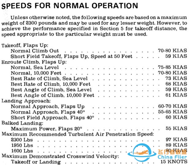

查阅机型的 POH 以了解飞机性能以及 Takeoff roll 的动力设置和各种速度 (Rotate, Best Rate Of Climb, Best Angle Of Climb, Stall) 。
X-Plane 11 新手入门指南-4234
C172 POH

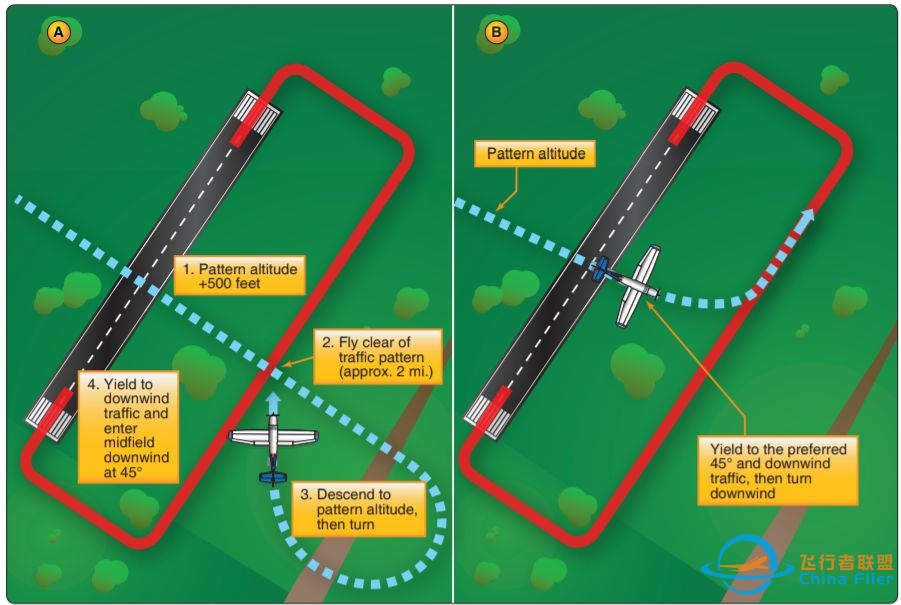

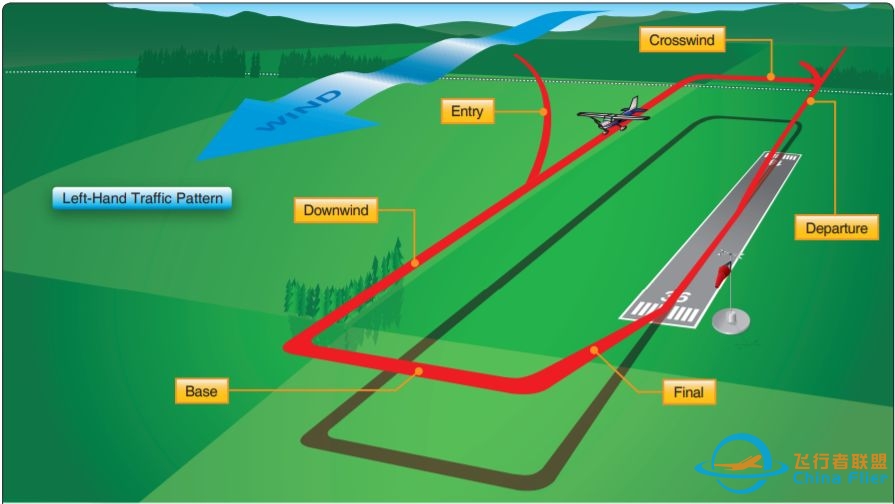

General Aviation 飞机按 traffic pattern 离场(见下图 ⑥)
VFR aircraft departing the airport should climb straight ahead on the runway heading until reaching the circuit traffic altitude before commencing a turn in any direction to an en-route heading. Turns back toward the circuit or airport should not be initiated until at least 500' above the circuit altitude.
The traffic pattern altitude is usually 1,000 feet above the elevation of the airport surface.
X-Plane 11 新手入门指南-4292
Traffic Patterns

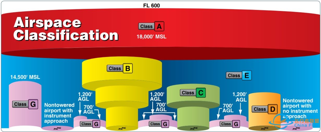

X-Plane 11 新手入门指南-2605
Airspace profile

General Aviation 根据 ATC 指引飞 Traffic Patterns:1,000 feet AGL 45° entry 进入 downwing leg(1 ⁄2 to 1 mile out from the landing runway, 注意图 A 中虚线标出的高度),速度降到 1.4 Vs0(失速速度,查POH)放下起落架随后转入 base leg 准备下降。航向合适的话也可以直接进入 Final approach。
Standard rule for the base turn is to wait until the runway is 45 degrees behind your left shoulder (in a left pattern) before banking.
X-Plane 11 新手入门指南-104
When approaching an airport for landing, the traffic pattern is normally entered at a 45° angle to the downwind leg, headed toward a point abeam the midpoint of the runway to be used for landing.
X-Plane 11 新手入门指南-1840
Preferred entry from upwind leg side of airport (A). Alternate midfield entry from upwind leg side of airport (B)

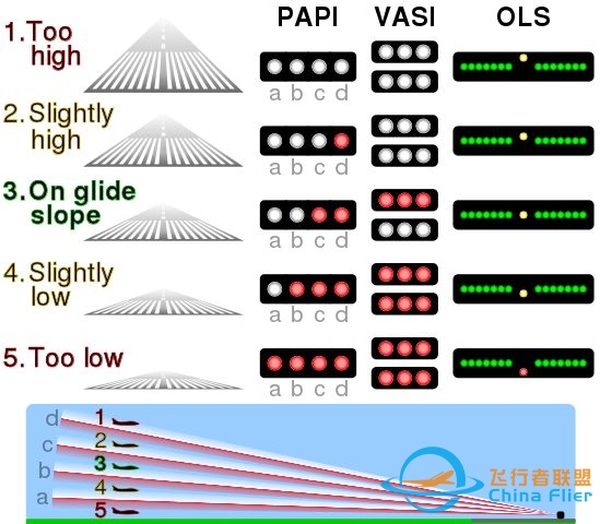

General Aviation 下降过程中不断减速,调节飞机的动力和俯仰使得垂直速度 (VSI) 保持在 400-500 FPM (Feet Per Minute) 左右;小飞机 capture 到 glide slope 后地速约 60 节 300 FPM,touch down 前 (30 ft) 空速接近失速速度,拉一下机头 (landing flare) 让 VSI 读数上升到 100 以下。
Glide slope 的 Visual Aids 看 PAPI 灯和跑道的 Aiming Point。

Glide slope 地面辅助设备有视觉 Precision Approach Path Indicator (PAPI) 和仪表 Instrument Landing System (ILS)

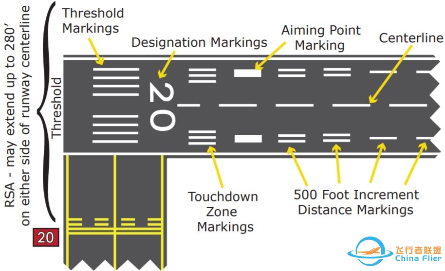

Runway Markings

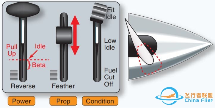

和活塞机不同,涡桨机螺旋桨采用固定的转速,通过调整叶片桨距来改变动力输出。
涡桨机一般有三个动力控制杆:Power(油门), Prop(转速), Condition.
PS: 有三个动力控制杆只是 variable-pitch propeller 的充分条件,游戏默认机型比较少这里就直接按引擎分类了。

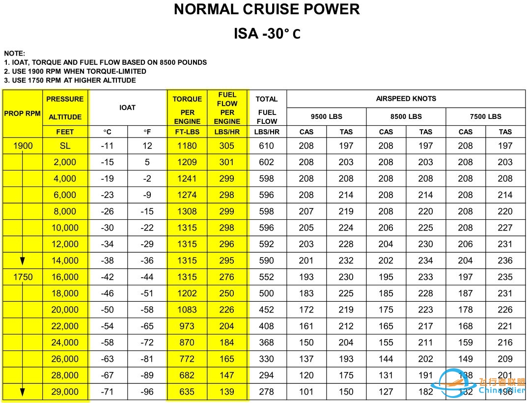

The power output of a piston engine is measured in horsepower (扭矩表) and is determined primarily by rpm (螺旋桨转速,Prop Control) and manifold (压力,Power Control) pressure.
不同工况下(起飞、爬升、巡航)按照 POH 设置转速 RPM 后调节油门 ("Prop on top": Increase RPM before increasing throttle. Reduce throttle before reducing RPM)。

Condition Lever:
Low-idle is used for starting and taxi; High-idle is used for normal flight and any time that extra bleed air is required (such as for the air conditioning with only one engine running). Cut-off is just that, it cuts-off fuel to the engine.
Leaning is not required in turbine engines; this function is performed automatically by a dedicated fuel control unit.
