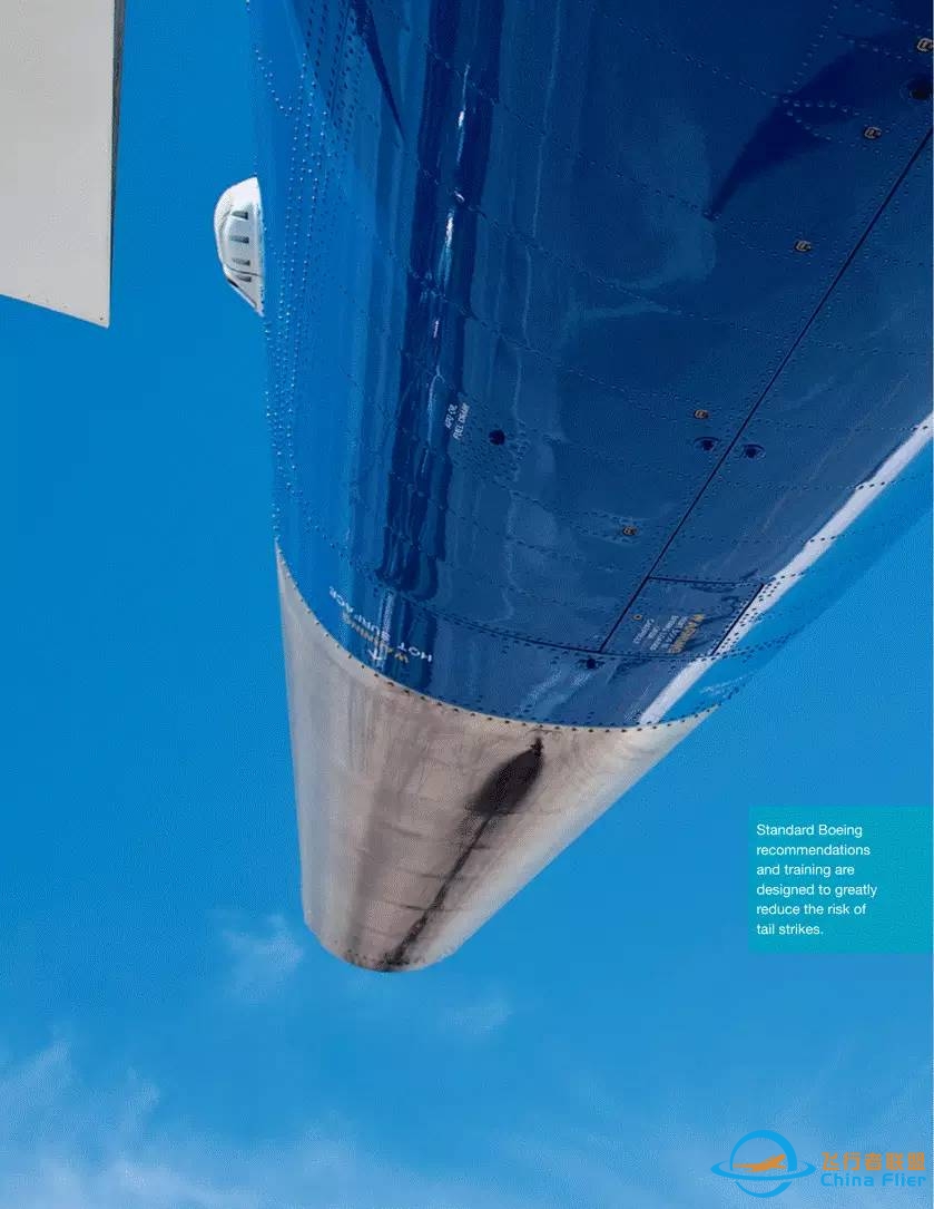

787 tail strike protection.During takeoff or landing, the primary flight computers calculate if a tail strike is imminent and decrease elevator deflection, if required, to reduce the potential for tail contact with the ground. Activation of tail strike protection does not provide feedback to the control column. Authority is limited so that pilot input can override its effect and rotate to tail contact attitude via additional column force. Protection does not degrade takeoff performance and is compatible with the autoland system.
787擦尾保护系统。在起飞或着陆中,主飞行计算机计算出将要发生擦尾时,如果需要时会减小升降舵偏转,以减小机尾触地的可能。擦尾保护的激活不会像控制杆提供反馈。这一功能的权限是受限的,因此飞行员输入能压制其效果并通过施加更大的驾驶杆力到达擦尾位置。保护功能不影响起飞性能,并与自动着陆系统相兼容。
787 tail strike detection system. The tail strike alert system detects ground contact which could damage the airplane pressure hull. A two-inch blade target and two proximity sensors are installed on the aft body of the airplane. The EICAS caution message TAIL STRIKE is displayed when a tail strike is detected. This indication is accompanied by a beeper and Master CAUTION light.
787擦尾探测系统。 擦尾告警系统可以探测会损坏飞机耐压壳体的触地现象。一个两英寸长的目标叶片(bladetarget)和两个接近传感器被安装到飞机的机尾。但探测到擦尾后,会显示一个TAILSTRIKE的EICAS告警信息。这个信息指示伴随有“哔哔”声和MasterCAUTION灯亮起。
777 tail strike protection. If installed, the flight control system receives input that a tail strike is imminent, and elevator deflection is decreased to reduce the potential for ground contact. Elevator deflection will not activate during a normal rotation and will not provide feedback to the control column.
777擦尾保护系统。如果安装了此系统,飞行控制系统会接收到擦尾即将发生的输入,升降偏转会被减小,以降低触地的几率。升降舵偏转不会在正常抬轮过程中被激活,也不会向操纵杆提供反馈。
777-300/-300ER semi-levered main landing gear. Because the vast majority of the weight of the airplane is borne by the lift of the wings at the time of rotation, the semi-levered gear acts as if it were pushing down like a longer gear. This allows a higher pitch attitude for the same tail clearance or more clearance for the same pitch attitude. A hydraulic strut provides the energy to provide this increased takeoff performance. Although designed to increase takeoff capability, it provides increased tail clearance for the same weight and thrust as non-equipped airplanes.
777-300/-300ER半摇臂起落架。因为飞机的绝大多数重量在抬轮时刻由机翼的升力承担,半摇臂起落架可以像一个更长的起落架一样发挥作用。这允许在保持相同的机尾间隙时使用更大的抬头姿态,或在相同的抬头姿态时具有更大的机尾间隙。液压支柱可以提供提升起飞性能的能量。尽管被设计用于增强起飞性能,与没有该装备的相同重量和推力的飞机相比,半摇臂起落架可以增加机尾间隙。
777-300/-300ER tail skid.The tail skid helps protect the pressurized part of the airplane from contact with the runway. The tail skid retracts and extends along with the landing gear and is connected to the center hydraulic system. If the tail skid position disagrees with the landing gear lever position, the EICAS advisory message TAIL SKID appears. Tail skid contact with the runway will not cause the TAIL STRIKE message to appear unless the tail strike sensor has also made contact.
777-300/-300ER尾橇。尾橇可以帮助保护飞机的耐压部分不与跑道接触。尾橇与起落架一起收放,并与中央液压系统相连。如果尾撬位置与起落架手柄位置不符,EICAS会显示TAILSKID信息。尾撬触底不会引发TAILSTRIKE信息显示,除非擦尾传感器也已经触地。
737-800/-900 tail skid.The tail skid assembly consists of a cartridge assembly, tail skid, fairing (skirt), and shoe. The fairing provides an enclosure for the actual tail skid structure. The shoe is fitted to the bottom of the fairing. The cartridge assembly consists of a crushable honeycomb material. When the tail skid strikes the runway, the skid moves upward and the honeycomb material crushes. The shoe contacts the runway in the event of an overrotation.
737-800/-900尾撬。尾撬组件由缓冲器、尾撬、整流罩和凸台组成。整流罩包围着真正的尾撬结构。凸台安装在整流罩的底部。缓冲器由可压蜂窝材料组成。当尾撬触底后,滑撬会向上移动,蜂窝材料被压坏。凸台会在抬轮过猛事件中触地。
Douglas twinjet tail bumpers.All Douglas twinjet models have tail bumpers similar to the tail skids on Boeing models.
道格拉斯双喷气机尾部保险杠。所有道格拉斯双喷气机型飞机装有尾部保险杠与波音飞机的尾撬类似。
MD-11 pitch attitude protection (PAP).The MD-11 has a PAP feature of the longitudinal stability augmentation system. Refer to the MD-11 Flight Crew Operations Manual for a detailed description.
MD-11俯仰角保护(PAP)。 MD-11飞机具有PAP纵向增稳系统。详情可参见MD-11飞机飞行操作手册。
If a Tail Strike Occurs
如果发生了机尾撞击
In the event that a tail strike occurs, the air carrier must perform. a tail skid inspection and tail strike inspection as specified in the Aircraft Maintenance Manual, chapter 5.
在发生机尾撞击时,航空公司必须按照维护手册第五章要求完成一次尾撬检查和机尾撞击检查。
Summary
总结
Tail strikes are preventable. Boeing’s recommendations for preventing tail strikes are consistent with Boeing’s philosophy of addressing operational issues through training, procedures, and technologies.
机尾撞击是可预防的。波音针对预防机尾撞击的建议与波音通过加强培训、严格执行程序并完善和提高相关飞行技术来应对运行事件的理念是一致的。
If standard recommendations are followed for all Boeing models, the chance of tail strikes is greatly reduced. Training is the key to preventing tail strikes.
如果波音的标准建议被所有机型遵循,那么发生机尾撞击的可能将大幅减少。培训是预防机尾撞击的关键。
