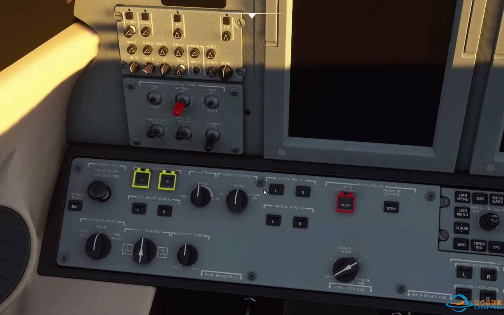

https://www.youtube.com/watch?v=bdmedizwiys&list=PLipstWw2WXsrgbamim0tytQlYg40d6jMf&index=1&t=5541s这个视频是安装了working-title航电增强插件的CJ4的教程搬运自油管。视频非常详细,所以有亿点点长,我分了两个发。第二个视频 https://b23.tv/fCo86u大家一起学习。

视频很长,我发一下油管评论区的目录
0:00 Start
0:33 CJ4 Background
01:02 Oxygen Supply
01:29 Oxygen Mask
01:47 Oxygen mask mic
02:00 Oxygen Control
01:40 Hydraulic Shutoff
02:27 Fuel Boost manual
02:41 Fuel transfer system
03:20 Climate Control system
06:15 FADEC Reset
07:03 Ignition Manual
07:10 Pressurization
08:08 Cabin Dump
09:10 Standard Pressure Controller
09:36 Pressurization System
10:38 Emer Brake Pull
11:46 Ice Protection System
12:41 Xflow button
13:13 Wing icing light
13:44 Copilot mic
14:55 TAWS G/S Cancel
14:18 Cockpit Speaker Button
15:05 Event Maker Button
15:35 Con1 tune
16:12 ELT Switch
16:23 Database loading ports
17:05 External Lights
19:02 Speed Brakes & Ground Spoilers
20:27 Throttle Levers
21:54 Engine Starter Button
22:21 Audio Panel

Electrical Panel:
-Generator Switches: 22:38
-Battery Switch: 23:13
-Emer Lights: 24:06
-Standby FTL Display Switch: 24:14
-Avionics Switch: 24:36
Engine Start Procedure: 25:43
-Starting tailwind limitations: 26:16
-Starting sequence: 27:22
Display Control Panel:
-PFD Menu & Formats: 30:05
-NAV Source:31:17
-Autopilot Source arrow:32:35
-Elapsed Timer: 33:27
-Format Button: 33:48
-Terrain/Wx button:34:16
-TFC Button: 34:27
-CCP Menu: 34:30
-Radar Menu: 35:13
-Refs Menu/Baro Mins: 36:01
-TAWS Menu: 36:22
Engine Fire Button: 36:54
Reversion Panel: 38:13
Flight Guidance Panel: 39:50

Legs Page Explanations & Waypoint Modifications: 1:09:56
Perf Menu: 1:13:24
Fuel Mgmt: 1:13:20
VNAV Setup: 1:15:02
Flight Log: 1:15:35
Approach Ref: 1:16:09
DSPL MENU: 1:16:17
MFD ADV: 1:17:53
