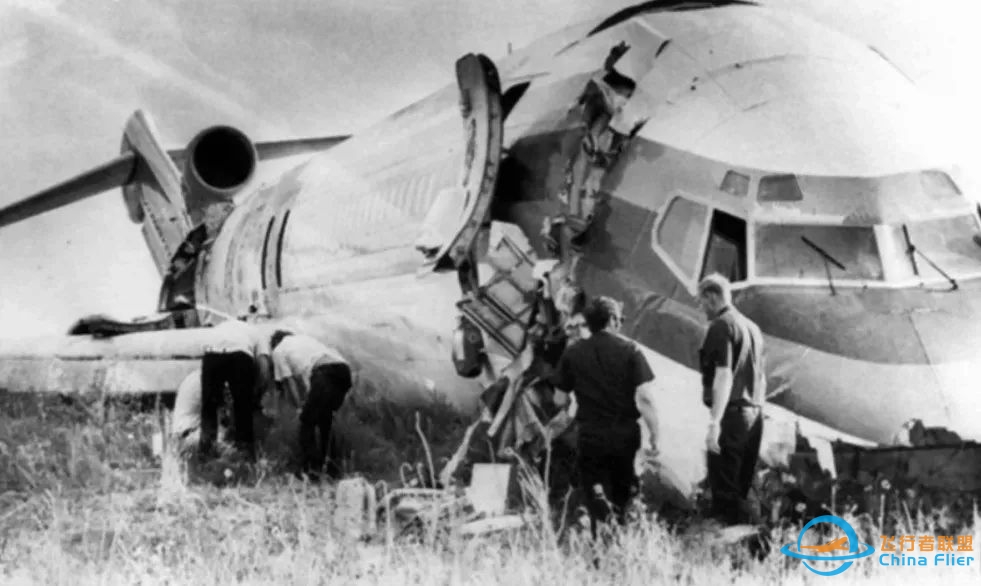

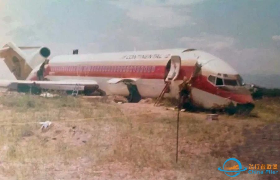

Just 11.6 seconds after the plane left the ground, the Boeing 727-200 passenger plane No. N88777 of Continental Airlines flight CO426 made its first touch with a belly "prostate landing" attitude 387 feet south of the extension line at the take-off end of runway 35L, 106 feet away from the right side of the runway centerline, and then the fuselage was bounced up, and then flew forward for another 153 feet before touching the ground for the second time. The fuselage at the air intake of Engine 3 on the centerline snapped, and then the lower part of the nose was torn due to ground friction, and finally the plane taxied forward for more than 1,100 feet before stopping, and the final stop position was 1,600 feet south of the take-off extension of runway 35L, 160 feet to the right of the runway centerline extension.
After the plane came to a standstill, Captain Price confirmed that no one was killed on the plane, but more than a dozen wounded people immediately ordered the cabin to evacuate, and at the same time called the airport tower to immediately send fire engines and ambulances. In fact, he did this redundantly, because the plane fell to the ground almost under the nose of the tower controller, who realized that the plane was about to crash when he noticed that the plane was falling in altitude, and immediately notified the fire engine and ambulance at the airport to dispatch immediately. Shortly after the plane hit the ground, the shrill sirens of fire engines and ambulances sounded in the distance.
