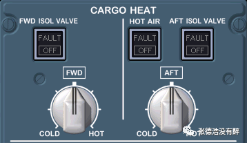

货舱加温 CARGO HEAT (选装)
参考 FCOM/DSC-21-40 Cargo
最最最最最全A320驾驶舱解读-4888

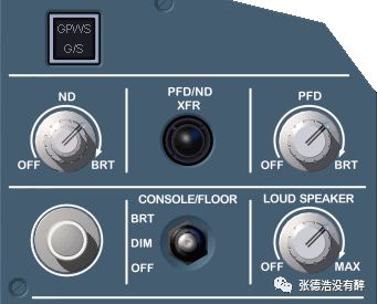

驾驶舱灯光 INT LT
参考 FCOM/DSC-33-10 Cockpit Lighting
最最最最最全A320驾驶舱解读-1104

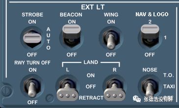

外部照明 EXT LT 参考 FCOM/DSC-33-20-20
最最最最最全A320驾驶舱解读-7895

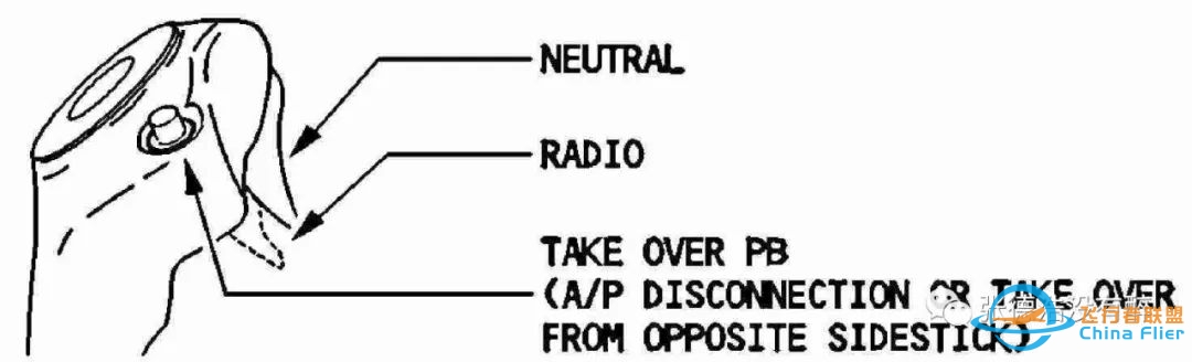

FCOM/DSC-27-20-30 SIDE STICK PRIORITY lt
最最最最最全A320驾驶舱解读-8010

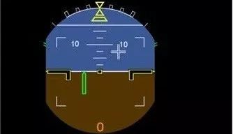

    Fixed Aircraft Symbol 固定飞机符号
    This symbol is in black, and outlined in yellow. The yellow outline is dimmed if the flight crew selects TRK-FPA, unless the FMA is in TOGA or FLX mode. 符号为黑色,边框是黄色,当飞行机组选择TRK-FPA黄色边框暗淡,除非FMA在TOGA或FLEX模式。
    Roll Scale 横滚刻度
    This scale is in white, and has markers at 0, 10, 20, 30, and 45 ° of bank.在坡度0, 10, 20, 30, 和45 °的位置标有白色的刻度。
    Roll Index (yellow) 横滚指标
    This pointer indicates the bank angle. When the bank angle exceeds 45 °, all the PFD symbols except those for attitude, speed, heading, altitude, and vertical speed, disappear. The display returns to normal when the bank angle decreases below 40 °. 此游标指示坡度。当坡度超过45 °,PFD上除姿态,速度,航向,高度和垂直速度以外的其它符号都消失。当坡度减小到低于40°时显示恢复正常。
    Pitch Scale (white) 俯仰刻度
    This scale has markers every 10 ° between 80 ° nose up and 80 ° nose down (every 2.5 ° between 10 ° nose down and 30 ° nose up). When pitch angle exceeds 25 ° nose up or 13 ° nose down, all the PFD displays except attitude, speed, speed trend, heading, altitude, and vertical speed disappear. Beyond 30 °, large red arrowheads indicate that the attitude has become excessive and show the direction to move the nose in order to reduce it. The display returns to normal when pitch angle becomes less than 22 ° nose up or 10 ° nose down. 在俯仰角±80°范围内每10°(30°抬头和10°低头范围中间是每2.5°)有个刻度。当俯仰角超出25°抬头或13°低头,PFD上除了姿态,速度,速度趋势,航向,高度和垂直速度以外的其它显示消失。超过30°,大红箭头表示姿态过量并指示移动机头的方向以减少幅度。当俯仰角少于22°抬头或10°低头显示恢复正常。
    Flight Control Protection Symbols 飞行操纵保护符号
    The display shows these symbols (=) in green:显示器以绿色呈现(=)符号
    • On the roll scale to mark the bank angle protection availability. 在横滚刻度上标记坡度保护的可用区间。
    • On the pitch scale at 15 ° nose down or 30 ° nose up to mark the pitch limits. 在俯仰刻度上位于15°抬头和30°低头以标记俯仰限制。
    An amber x replaces these symbols if the corresponding protection is lost. 当失去对应的保护,琥珀色的x取代这些符号。
    (参考 FCOM/DSC-27-20-10-20 Protections - General)
    Sideslip Index (yellow) 侧滑指标
    This trapezoidal index moves beneath the roll index. On ground, it represents the lateral acceleration of the aircraft. In flight, it shows sideslip (as computed by the FAC). One centimeter of displacement indicates 0.2 g. The sideslip index is against its stop at 0.3 g. 梯形指标在横滚指标底下移动。在地面上表示飞机的横向加速度,飞行中则指示侧滑(由FAC计算)。1厘米的偏移表示0.2 g。侧滑指标在0.3 g 达到量程极限。
最最最最最全A320驾驶舱解读-9457
最最最最最全A320驾驶舱解读-1989
In case of engine failure at takeoff or go around, the sideslip index changes from yellow to blue.在发动机失效的起飞和复飞时,侧滑指标由黄变蓝
In this case, the sideslip index is called β target. 在这种情况下,侧滑指标被称为 β 目标。

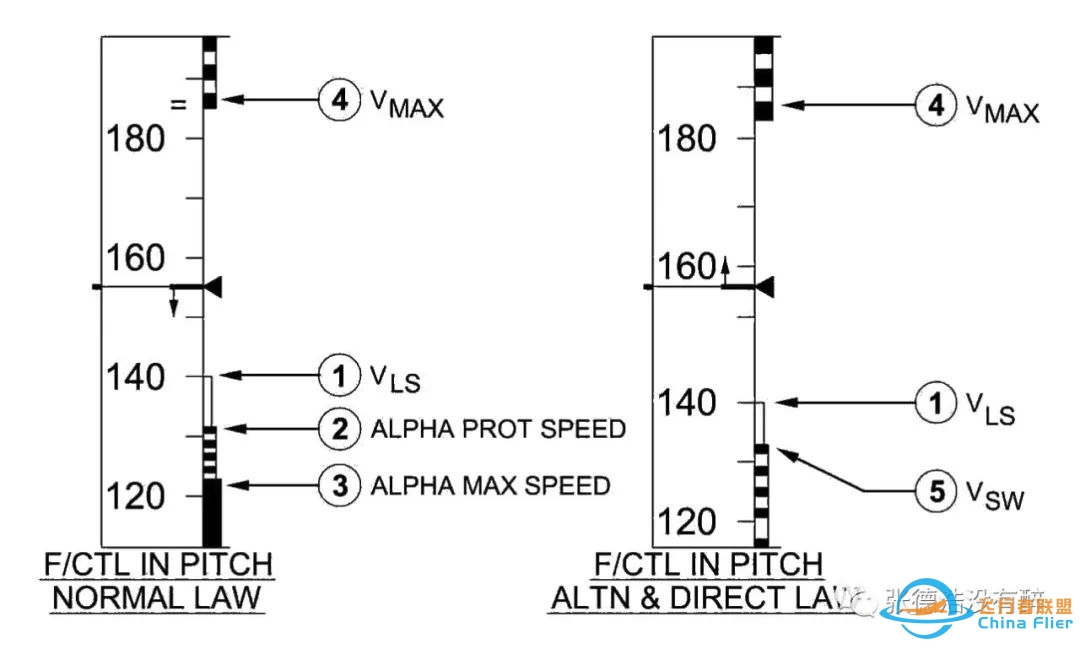

空速 Airspeed
最最最最最全A320驾驶舱解读-1549
    Actual Airspeed Reference Line and Scale 实际空速基准线及刻度
    A white scale, on a grey background, moves in front of a fixed yellow reference line (next to a yellow triangle) to indicate airspeed. The minimum airspeed indication is 30 kt. 最小的空速指示是30 kt。
    Speed Trend (yellow) 速度趋势
    This pointer starts at the speed symbol. The tip indicates the speed the aircraft will reach in 10 s, if its acceleration remains constant. 速度变化稳定时,箭头指示空速在10秒后将要达到的位置。
    It also disappears, if the FACs fail. 当FAC失效也会消失。

    Minimum Selectable Speed (VLS) 最小可选速度
    The top of the amber strip along the speed scale indicates this speed. It represents the lowest selectable speed providing an appropriate margin to the stall speed. 最小可选速度在失速速度之上提供适当的余度(Refer to DSC-27-20-10-20 Protections - High Speed Protection)
    VLS information is inhibited from touchdown until 10 s after liftoff. VLS信息在接地以后到离地10内被抑制。
    Alpha Protection Speed 迎角保护速度
    The top of a black and amber strip along the speed scale indicates this speed. It represents the speed corresponding to the angle of attack at which alpha protection becomes active 表示α保护被激活时的迎角所对应的空速(Refer to DSC-27-20-10-20 Protections - General).
    It is displayed when in pitch normal law. 俯仰正常法则下显示。
    Alpha MAX Speed 最大迎角速度
    The top of a red strip along the speed scale indicates this speed. It represents the speed corresponding to the maximum angle of attack that the aircraft can attain in pitch normal law 表示飞机在俯仰正常法则下所能达到的最大迎角对应的空速(Refer to DSC-27-20-10-20 Protections - General).
    VMAX 最大速度
    The lower end of a red and black strip along the speed scale defines this speed.
    It is the lowest of the following: 以下的最低值
    ‐ VMO or the speed corresponding to MMO
    ‐ VLE
    ‐ VFE
    Stall Warning Speed (VSW) 失速警告速度
    The top of a red and black strip along the speed scale defines this speed.
    It is the speed corresponding to the stall warning. 失速警告对应的空速(Refer to DSC-27-20-10-20 Protections - General).
    VSW information is inhibited from touchdown until 5 s after liftoff. VSW在接地以后到离地五秒内被抑制。
    It is displayed when operating in pitch alternate or pitch direct law. 在俯仰备用法则或俯仰直接法则下显示。

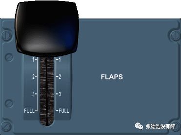

    Minimum Flap Retraction Speed 最小收襟翼速度
    This is a green symbol (letter F).
    It appears when the flap selector is in position 3 or 2. 当襟翼手柄位于3或2出现(Refer to DSC-27-20-10-20 Protections - High Speed Protection).
    Minimum Slat Retraction Speed 最小收缝翼速度
    This is a green symbol (letter S).
    It appears when the flap selector is in position 1. 当襟翼手柄位于1时出现(Refer to DSC-27-20-10-20 Protections - High Speed Protection).

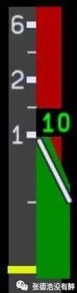

垂直速度 Vertical Speed
The displayed vertical speed information is normally based on both inertial and barometric data. 垂直速度显示基于惯性和气压数据合成。If inertial data is not available, it is automatically replaced by barometric information. 当惯性数据不可用,自动由气压信息代替。
In this case, the window around the numerical value becomes amber.这种情况包围数值的窗口显示琥珀色。
最最最最最全A320驾驶舱解读-6014
    Analog pointer 模拟指针
    This pointer, which is normally in green, points to a white vertical speed scale, displayed on a grey background
    Digital indication 数字指示
    This number, normally in green, is the vertical speed in hundreds of feet per minute. 数字单位是100ft/min。It disappears, if the vertical speed is less than 200 ft/min. 垂直速度小于200ft/min时消失
    The analog pointer and the digital indication become amber, if:
    • V/S is greater than 6 000 ft/min, (climb or descent)
    • V/S is greater than 2 000 ft/min, during descent when 1 000 ft < RA < 2 500 ft, or
    • V/S is greater than 1 200 ft/min, during descent and RA < 1 000 ft.

PFD显示的故障旗和信息
最最最最最全A320驾驶舱解读-2964
参考 FCOM/DSC-31-40 Flags and Messages Displayed on PFD
最最最最最全A320驾驶舱解读-3790

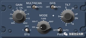

气象雷达 & PWS FCOM/DSC-34-SURV-30-30
最最最最最全A320驾驶舱解读-8359
    Weather Radar Picture 气象雷达图像
    Tilt Angle 倾斜角
    Gain Mode 增益模式
    Failure Messages 故障信息
    Path Attenuation Compensation (PAC) Alert PAC警告

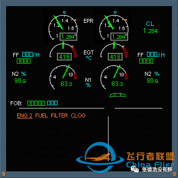

The Engine Warning Display (E/WD) appears on the ECAM's upper Display Unit (DU). 参考 FCOM/DSC-31-15
‐ The upper part of this DU displays:
• Engine parameters 发动机参数(Refer to DSC-70-90-40 Engine Warning Display)
• Feedback messages 反馈信息(Refer to DSC-31-05-60 Feedback Messages)
• Fuel On Board (FOB) 机载燃油(Refer to DSC-28-20 ECAM Upper Display)
• Slats/Flaps' position 缝翼/襟翼位置(Refer to DSC-27-30-20 ECAM Upper Display)
‐ The lower part of this DU displays messages generated by the FWC:
• Warning and caution messages, when a failure occurs 发生故障时的警告和注意信息
• Memos when there is no failure. 没有故障显示备忘信息
E/WD (CFM)
最最最最最全A320驾驶舱解读-8679
E/WD (IAE)
最最最最最全A320驾驶舱解读-7870
The lower part of the DU, dedicated to ECAM messages, is divided into two sections of several lines each.
Bottom left : ‐ Primary or independent warnings and cautions, or 主要或独立的警告和注意,或
‐ Memo information. 备忘信息

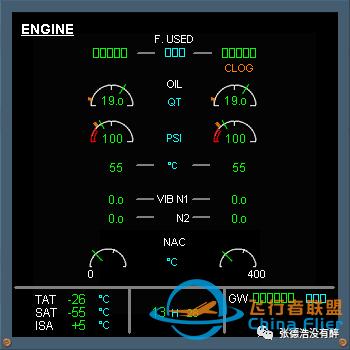

SD 系统显示器 参考 FCOM/DSC-31-20

The lower ECAM DU can display 12 system pages (For description see relevant FCOM chapter): 一共有12个系统页面
‐ ENGINE (secondary engine parameters) 次要发动机参数
‐ BLEED (air bleed) 引气
‐ CAB PRESS (cabin pressurization) 客舱增压
‐ ELEC (electric power) 电源
‐ HYD (hydraulic) 液压
‐ FUEL (fuel) 燃油
‐ APU (auxiliary power unit) 辅助动力单元
‐ COND (air conditioning) 空调
‐ DOOR/OXY (doors/oxygen) 舱门/氧气
‐ WHEEL (landing gear, braking, ground spoilers, etc.) 起落架,刹车,扰流板等
‐ F/CTL (flight controls) 飞行操纵
‐ CRUISE (cruise) 巡航

‐ The Engine Warning Display (EWD) displays the title of the alert related to the failure
最最最最最全A320驾驶舱解读-9302
发动机警告显示器(EWD)显示与失效有关的告警标题

侧仪表面板
最最最最最全A320驾驶舱解读-577
FCOM/DSC-34-SURV-40-40 PULL UP – GPWS pushbutton
FCOM/DSC-31-50 OFF/BRT knobs & PFD/ND Pushbutton
FCOM/DSC-23-10-50 Loudspeaker Volume Knob
FCOM/DSC-33-10-30 CONSOLE/FLOOR sw

气象雷达
FCOM/DSC-34-SURV-30 Weather Radar

襟翼 FCOM/DSC-27-30-20
最最最最最全A320驾驶舱解读-6301
Before selecting any position, the pilot must pull the lever out of the detent. Balks at positions 1 and 3 prevent the pilot from calling for excessive flap/slat travel with a single action. 选择任何位置之前必须将手柄从卡位中拉起。位置1和3有阻挡,防止飞行员一次动作导致过多的襟缝翼行程。
Note: The pilot cannot select an intermediate lever position. 飞行员无法选择手柄档位之间的位置

侧杆 FCOM/DSC-27-20-30 Sidesiticks
最最最最最全A320驾驶舱解读-4554
Each pilot has on his lateral console a sidestick he can use to control pitch and roll manually. Each sidestick is springloaded to neutral. 侧杆弹性回到中立
When the autopilot is engaged, a solenoid-operated detent locks both sidesticks in the neutral position. 当接通自动驾驶,侧杆电磁锁定在中立位。If the pilot applies a force above a given threshold (5 daN in pitch, 3.5 daN in roll) the stick becomes free and the autopilot disengages. 飞行员在侧杆上施加力量超过阈值(俯仰50 N,横滚35 N)侧杆被释放同时自动驾驶解除。
The hand grip has two switches: 手柄有两个开关
‐ Autopilot disconnect and sidestick takeover pushbutton. 自动驾驶解除和侧杆接管按钮
‐ Push-to-talk button.
最最最最最全A320驾驶舱解读-1268
Sidestick priority logic 侧杆优先逻辑
‐ When only one pilot operates the sidestick, it sends his control signals to the computers. 只有一个飞行员操作侧杆,信号传输给计算机。
‐ When the pilots move both side stick simultaneously in the same or opposite direction and neither takes priority, the system adds the signals of both pilots algebraically. The total is limited to the signal that would result from the maximum deflection of a single sidestick. 当俩飞行员同时移动侧杆并且没有取得优先权,系统代数叠加两边的信号。叠加的信号和单侧杆偏转的信号极限相同。
A pilot can deactivate the other stick and take full control by pressing and keeping pressed his priority takeover pushbutton. 飞行员可以通过持续按压优先权接管按钮抑制另一个侧杆获得完全操纵。
For latching the priority condition, it is recommended to press the takeover push button for more than 40 s. 为了保持优先权,建议按压接管按钮40秒以上。
最最最最最全A320驾驶舱解读-5715

Either pilot can deactivate the other pilot’s sidestick by pressing on their sidestick pb.两名飞行员的其中一个可通过按压其侧杆按钮使另一名飞行员的侧杆被抑制。
