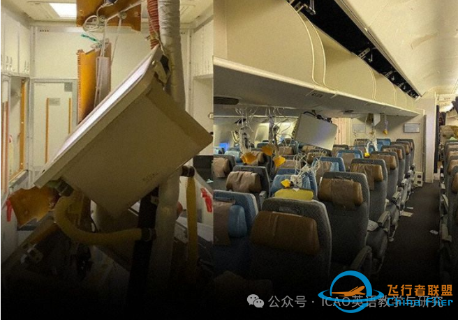

1.severe turbulence kills one andinjures 37
On May 21, 2024, Singapore Airlines 321from London Heathrow (UK) to Singapore (Singapore) with 211 passengers and 18crew, was enroute at FL370 when the aircraft suffered severe turbulencecausing injuries to a number of passengers. The crew descended the aircraft toFL310 and decided to divert to Bangkok where the aircraft landed on runway 19Rabout 30 minutes later. One passenger was pronounced dead upon arrival, 30passengers and 7 crew were taken to hospitals.
The airline confirmed there had been severeturbulence causing one fatality and injuries on board of flight SQ-321. Theairline later reported: "As of 1950hrs Singapore time on 21 May 2024, 18individuals have been hospitalised. Another 12 are being treated in hospitals."
Authorities in Bangkok reported a British citizen(73) on board died as result of a heart attack. Seven people are in criticalconditions. 23 other passengers and 7 crew received injuries of varying degrees.

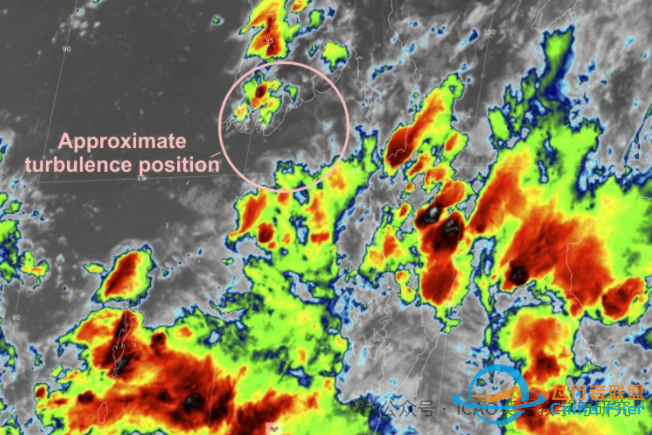

According to ADS-B data the speed over ground ofthe aircraft dropped rapidly by about 20 knots prior to starting the(controlled) descent from FL370 to FL310. The data also reveal the aircraft hadexperienced an altitude deviation of -100/+300 feet about 350nm westnorthwestof Bangkok while enroute at FL370 over Myanmar about 15 minutes earlier.
2024年5月21日,新加坡航空321航班从伦敦希思罗机场(英国)飞往新加坡(新加坡),搭载211名乘客和18名机组人员,在航路上FL370,飞机遭遇严重湍流,造成多名乘客受伤。机组人员将下降到FL310,并决定备降曼谷,大约30分钟后飞机降落在19R跑道上。一名乘客在抵达时被宣布死亡,30名乘客和7名机组人员被送往医院。
该航空公司证实,SQ-321航班遭遇严重湍流,造成一人死伤。该航空公司随后报道称:“截至新加坡时间2024年5月21日19时50分,已有18人住院治疗。另有12人正在医院接受治疗。”
曼谷当局报告称,机上一名英国公民(73岁)死于心脏病发作。七人情况危急。23名其他乘客和7名机组人员不同程度受伤。
根据ADS-B数据,在开始从FL370(受控)下降到FL310之前,飞机的地速迅速下降了约20节。数据还显示,大约15分钟前,这架飞机飞跃缅甸上空,FL370,在曼谷西北偏西约350海里处出现了-100/+300英尺的高度偏差。
